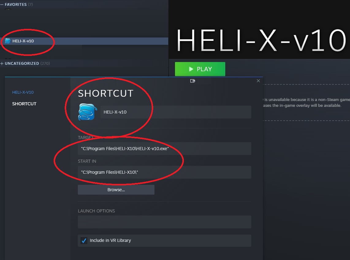

So i just used this script == link below
Create a batch file with that script \ copy pasted, You drag the run-HeliX bat file onto it .. it creates the EXE
Add the EXE to steam as non-steam game as normal method.
I changed the iccon to the heli-X.ico file from the simulator install directory.
Run the game from steam - steam link it.
https://www.howtogeek.com/50364/convert ... -exe-file/

azaz44 wrote: 07 Oct 2022 22:16 I stream from my PC (2 floors below) to Android TV (nvidia Shield)
Maybe it maters, maybe it doesnt - but I actually have the "actual" Valve steam link 'box' on my TV, not through Nvidia shield OR the Android Team link app.
IT loads fine, shows all the black java code on the TV first, then the main simulator splash screen and away i fly wirelessly.
I am using RX2Sim with a proper RX receiver etc, not up\down stairs - but a good 50 meters away from my office\study where my main steam gaming PC is and my Rx2Sim dongle etc and it works pretty well.
